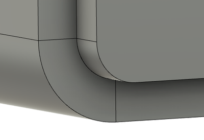

I am working on a box design out of 3/16" aluminum sheet metal. the picture shows the corner mitered flange gap at the top/rim of the box (formed that way for strength/rigidity).  I think the material will allow for tighter gap in the mitered flange (I am ok with the gap on the radiused part of the corner but open to suggestions there as well).
Also the fabricator recommends two opposite sides of the box be welded on.  So my workflow was to create the bottom & sides as one body, create a new offset plane and sketch the front panel to meet the 3 edges of the bottom & sides, create that as a SHEET METAL flange outward from the plane and then go into the SOLIDS tab to combine the two bodies, that allowed me to pull the 3 top flanges into the configuration in the picture (prior to combining I wasn't able to pull the 3 flanges together and take advantage of the miter/linear weld function at the corners).  Will I be able to separate the front panel later and supply the fabricator with 2 flat patterns for cutting from the sheet stock?
thanks tons.

aliobidi
Hi ,
you can save this option when it separate then work what do you want on it and make option 2
or you can back on timeline
also you will be able to separate in future if the geometry is clean
there is a lot options  make what you see the best for you

thanks, good to know I can easily separate later.  here is a better view of how I put the front panel in place (only meeting at the apex of the sheet metal edges).
this view also shows how large the gap is that needs to be spanned when welding the panel in place.
Just to make sure - so your Design Intent is for this to be 3 components?
I can do it just as it is, but making sure of the true Design Intent before I start.
If yes, is this the desired position of the end caps (to the outside, not to the inside)?
Message 7 of 12
timothybdk
yes, wanting to have mitered looking welded corners.

this looks to be satisfactory to the welder, great!  thanks.  I have looked into the timeline a bit and tried to follow the workflow but I think you are a magician so far.  could you tell me was the profile of the cut to either side of the mitered flange joint something you knew from experience or calculated or generated by a feature in the software?

Tip: follow the timeline from the beginning to see the workflow!
