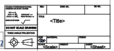

I'm currently working with both Fusion and Onshape for various different projects. I've created a template in Fusion 360 but cannot seem to export it as DWT for uses in other programs. Is it possible to export a fusion template into a DWT file format?

you can export the file to AutoCAD As (DXF) then save as from AutoCAD As (DWT)

Unfortunately, there is no way to export your Fusion template file to DWT format.
If you have access to AutoCAD, I would suggest that you save your template file as a DWG and then convert it to DWT in AutoCAD. This will bring through all of your attributes etc.
