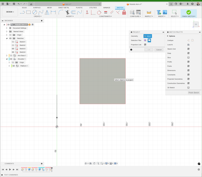

Ok. Lets make the Shoulder. Make the Top Component Active. New Component - call it Shoulder. I am going to use
the Build in Place Method first. Make my Sketch visible again after the extrude. Make a new Sketch, this time use
the top of my Base as the Plane, not the Origin Plane. See how I can see my original sketch through the Base?
I want to use my Construction Lines to locate the Centre of the Base to create the small Platform sketch. To do this
I will Project the parts of this sketch I need into my new Sketch. Press P and click on the Centre Point.
Hit Ok and turn the visibility of my Base OFF, now I have a purple dot. Create a Centre Point Rectangle the size of
the Platform.
