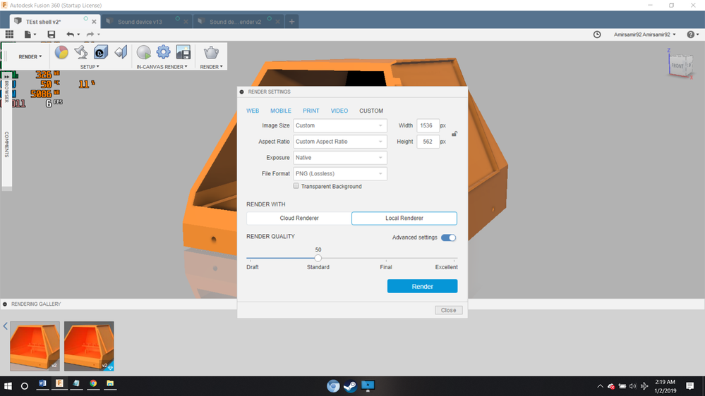

When I preview what I am about to render, I see this
But when I render the image, it turns out much brighter, like this
This is with the default settings
The same issue occurs if I do an In-Canvas Render
How do I get the rendered image to look like the preview?

Are you comparing the final result to the In-Canvas-Renderer? If not start it with the start icon. You can limit the resolution (limit the used resources) by clicking the gear icon.06-01-2019 18-17-52.png
