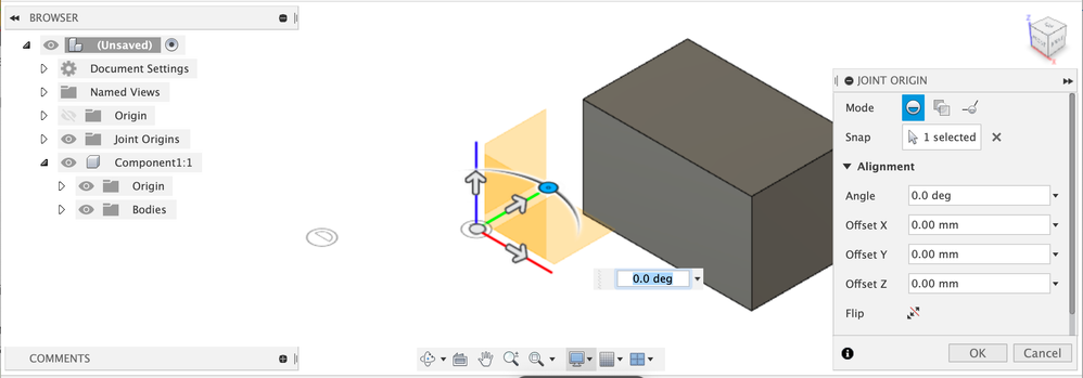

I can create a Joint Origin at the component origin.  Either the root component:
Or at the origin of a sub-component:
Can you post a video of what you are doing that is different?  I start off with an empty design, and I can create a Joint Origin at the root component origin, or create a component, and create a Joint Origin at that component's origin.  Are you doing something different?
Thanks.
Jeff Strater
Engineering Director
worknstuff
i just found it works - if you click in the design space after selecting the origin.
the old behaviour did not require this additional click into the design space.
the same thing applies when joining component origins.

This is known issue and it's been getting tracked internally with FUS-71196.
Easy workaround is that after selection of origin in the dialog simply just click once in the workspace and OK button will enabled.
