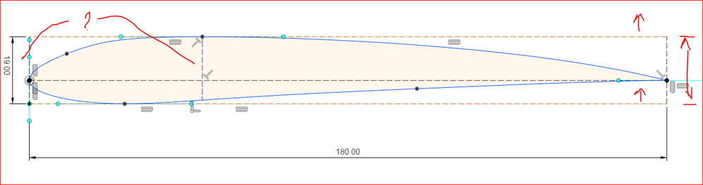

I've got my outline as a sketch and my profile as a sketch. How do I resize my profile so it matches the outline?
Once I have the width correct, how do I make the profile height 19mm? There isn't a single vertical line to measure, I need to measure the bounding box height.

davebYYPCU
I am not on the same page, - there are a few ways to measure the 19mm.
if you are sticking to a known airfoil shape, then the 19mm thickness will equal a set and known chord length.
If you don't need THAT airfoil, make your own, with a rectangle bounding box, which is what I am thinking you are saying.  Rectangle is chord length by 19mm high, making the trailing edge and leading edge, horizontally apart, the top and bottom lines are adjustable for best / better shaping, and would work if measuring the internal vertical line.
After the airfoil is settled and aligned to the origin, you project the LE and TE points to the top view sketch, and complete the top view sketch snapping to those points, this way changing the airfoil chord changes the top view automatically.
Might help....
Message 6 of 9
I'm being really thick. How did you make that surrounding box? I figured it out: https://www.youtube.com/watch?v=T1a9iEDWdzY
Like you said, I would like the profile to be 19mm at the widest wing point, then as the profile moves towards the wings it scales the depth with the chord.
I just took a look at the ? labelled part of your diagram .... now you've got me thinking.... I don't know which part should be 19mm ..... hmmmm lol!!
Thanks for the help, appreciate it!!

Message 8 of 9
OMG thank you for all this help, if I could reach through my screen and give you a hug, I would!
I'm using Eppler 817 ( http://airfoiltools.com/airfoil/details?airfoil=e817-il ) at 3 degrees positive AoA. I attempted to import the SVG but I didn't get it right, so I drew around it.
Fusion360_2019-07-09_22-36-04.pngThis is at 3 deg AoA. I can't resize it using the construction lines, so those are not connected properly
Top view of the wing, I'm not 100% sure it is the correct size. It should have an area of 950 square cm, don't know how to do this.
The centre profile should be 19mm depth, length is ? Not sure. Don't know how to measure it.

davebYYPCU
Ok, had a fiddle with your pics.
for a rib thickness, 19mm, the chord line is 173.691 mm, and the top view wing area for that set of sizes, is 584 sq cms.
Something has to give, to get to 950 sq cm.  Let me know.
