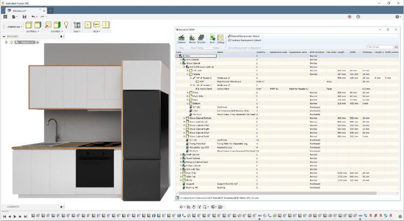

Thanks @Marco.Takx, I already use Joinercad which seems to be really efficient to get BOM but does not help in designing. Its software developer made an add-in called Woodwork for Inventor which seems to be perfect for designing kitchens, but it is way too expensive and works only on Inventor...

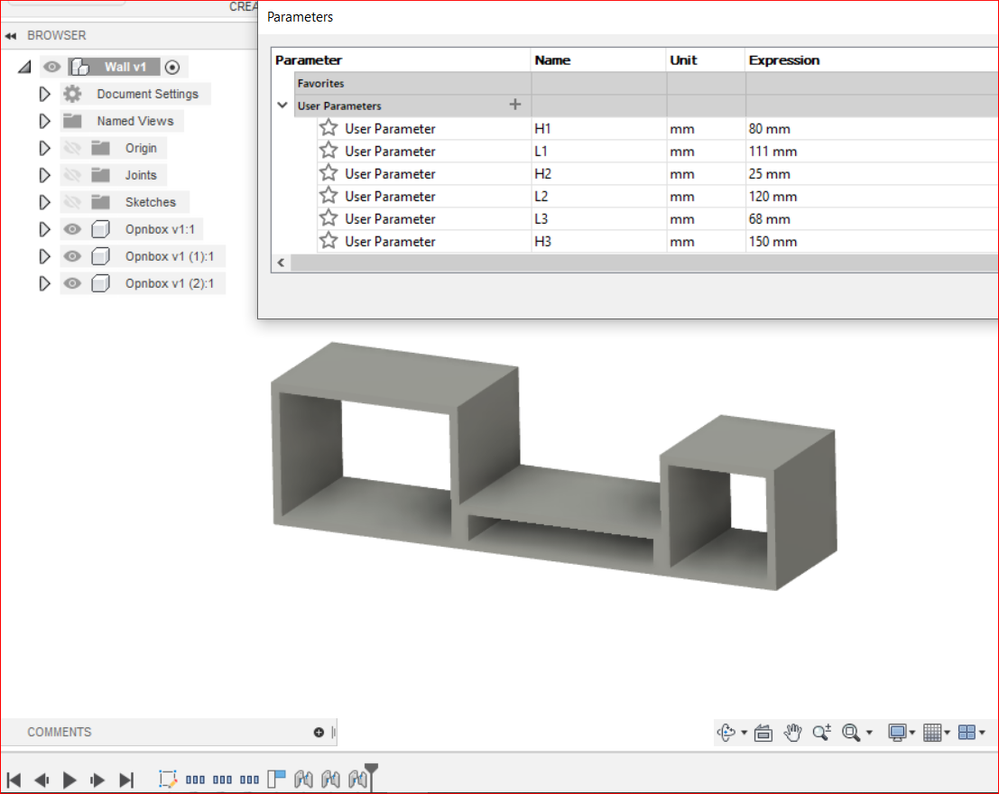

davebYYPCU
Not sure why yours does not work, I can do as I said.
Change the values of any of the first 6 parameters. Values must be greater than 10mm
Might help.....
Message 6 of 10
Hey @davebYYPCU , thanks for your quick answer! I wanted to make many tests before answering you and it took some time...
You model helped me a lot to understand what is wrong with mines. I still have an issue with the way I make joints.
I have tried to redo the joints on your model on the 2nd and 3rd boxes.
- 3rd box : the joint is on the left down corner of the box and of the main sketch, and have a problem when I change the dimensions.
- 2nd box : the joint is on the center of box' sketch and of the main sketch, and I don't have any problem!
When I check the 1st box, I see a joint on the left down corner... How have you done it?
Thanks a lot

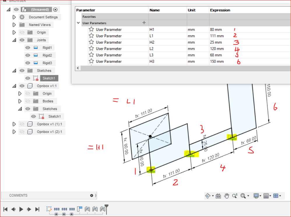

What I did,  - very simple.
Layout sketch, with dimensions - when making dimension 1, type in "H1", for the value, sketch will say FX:80.00
and Dimension 2 type in "L1" for the value, sketch will say FX: 111.00
repeat for other 4 dimensions, parameter name for value. (L2 H2 H3 L3)
For component 2, first box, sketch centre rectangle, and
dimension, type in H1, for the value and type in "L1" for the value,
make 4 box sides, use Thickness parameter (I used Shell command.)
repeat for 2 more boxes.
Layout sketch is component 1, fixed to origin, and can't move.
Joint Component 2, rigid, and left lower corner of box front goes on lower left corner of layout sketch.
Joint Component 3, rigid, and left lower corner of box front goes on middle lower left corner of layout sketch.
Joint Component 4, rigid, and left lower corner of box front goes on right lower left corner of layout sketch.
Open Parameter window, and change any value in top 6 user parameters.
Model will behave as expected.
Might help....
