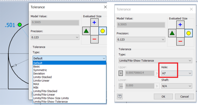

TheCADWhisperer
@TrippyLighting wrote:
In the meantime, if you need this , you'll have to use a more traditional, mature CAD system like Autodesk Inventor. I am not sure it includes this functionality. @TheCADWhisperer can answer this.
Limits and Fits are everywhere you would expect to find them in Autodesk Inventor Professional.
In a multitude of locations in appropriate formats - but here is one example...
