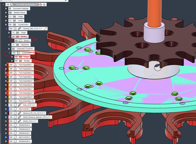

I am trying to use a rigid joint to join the together an assembly to a part.  When I do, the assembly breaks apart.  See below.  I did select the entire assembly when appying the joint.
Any thoughts on this one?
Thanks... Richard

I'm only seeing one joint to the central disk for the forks on the sub-assembly file. How were the other forks located/constrained?
Message 3 of 23
bwalker145
Ah, I see. The other forks are "pinned".
Unpin and use joints to locate to the central disk. Can either do individually, or quickest would be a rigid group to the first fork that already has a joint.
Edit: Or if you don't want to mess with any of it, just unpin all the forks & central disk, and use "ground-to-parent" in the sub-assembly instead. Would recommend Joints though.

Thank you.  I am a bit new to these sub assemblies.  I sketched most of this part but not the fork assembly.  I increased the size of the disk (green) but I do not see how I move each of the forks.  They seem to be pinned and joints.  I would prefer to use a joint for each fork location.
Message 5 of 23
bwalker145
Yeah if you want everything to update appropriately with parametric changes, definitely use joints and try to stay away from pinning/grounding.
First thing I see is there are two bodies/components associated with the Central Disk (Purple and Blue). The fork assemblies currently line up with the Purple disk. Which disk is correct one for your assembly?

The purple was the original disk.  I replace it with the blue.  Ideally, I would like the forks to be jointed to the blue disk.  I tried unsuccessfully to make some changes so here is the updated version.
Message 7 of 23
bwalker145
Try this out, file attached.
Not the cleanest, since I didn't want to re-do certain parts of the design, but the fork/disk assembly should be correctly constrained, and the forks should adjust location with disk size updates. I didn't touch anything else. Looks like there's some interference with that green backing plate.

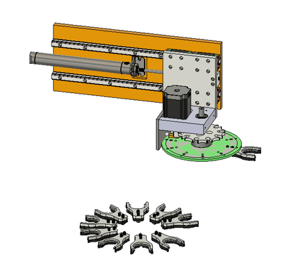

Thanks guys.  This project started with an assembly that was created by someone else, so I had a hard time making it right.  I am new to assemblies and joints so this was very helpful.  Here is a screen shot of the finished part.  Thank you very much!
