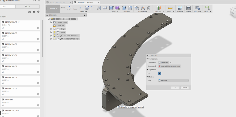

joint problem
hato54
When a make the joint it's ok, no warnings. Then when I edit the joint I have this "missing joint origing reference".
The part has rotating joint in 3 axis but this joint i rigid.

Message 14 of 20
hato54
@James.Youmatz, I made a new simply assembly using three components, still a have the same error (when I edit the last joint)
No errors when Compute all.
Message 15 of 20
James.Youmatz
Autodesk Support
Autodesk Support
Hi @hato54,
Very strange - I see the same error you do. Luckily to fix this if you edit the joint and then just reselect the joint origin for the missing joint reference, it seems to clear up just fine. What's concerning is how often this is happening. The one thing I do notice - is this seems to be the same piece that was having an issue in your last assembly. Have you been noticing this with any other parts at all - or just this one? I will keep digging into your model to see if I can discover the root cause of this. Attached is my .f3z model with the fix.

Message 18 of 20
James.Youmatz
Autodesk Support
Autodesk Support
Hi @hato54,
I went over this with some teammates and the strange thing is that a Compute All does not trigger this error message. It's almost as if it knows that the joint exists and what the origins are, but the dialog is displaying that there is a missing reference. I have to go ahead and log this with development for them to take a peek at. I will keep playing with this to see if we can find what is the cause of this (as it seems to be related to this one part or how the joint is being created).

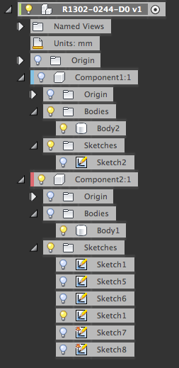

TrippyLighting
While I am not sure it has anything to do with the joint problem the structure of your assembly is suboptimal and would be the result of not following R.U.L.E #1.
The linked component as shown by the symbol is actually an assembly with one other component in it that has one body in it. It looks like this:
But should look like this:
Even worse in this linked component you have one body on the top level, then you ave another component in it that contains another body.
That should look like this and should be assembled properly within that linked assembly (I have not done that), because otherwise one of the components will just be un-constrained.
