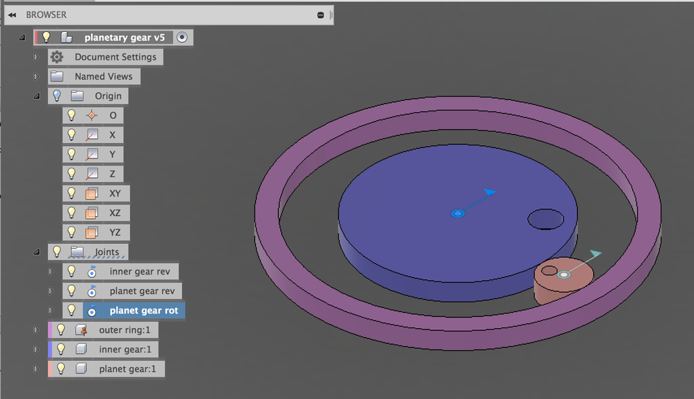

Hi all, I'm trying to familiarize with fusion360 and trying to realize a planetary gearbox like this one:
http://bestanimations.com/Science/Gears/planetary-gear-set-animation-5.gif#.WhlTMjkALFY.link
So, I can move the central spurg gear around its axis, but I can't move the 4 planet gear around both axis I need (itself and around the central spur).
Someone can help me with joints and motion?
Thanks in advance.

Well, I admit defeat on this one.  I tried a bunch of approaches, using joints and Motion Links.  Even Motion Study seemed to have problems with this.
For anyone who wants to take a crack at this, here is a simplified model:
Model is attached.
Jeff

I believe this can only be achieved with the use of a 4th component,the planetary gear carrier. Without that component a planetary gear would be relatively useless.
Two motion links and a little math will take care of the rest. I might have oversimplified the calculation for the motion ratio of the planetary gear, but in concept the assembly works as intended.
Message 6 of 10
jeff_strater
Very nice, @TrippyLighting.  I should have done more research on the mechanism itself!  Thanks for the solution.

Thank all for your reply.
I'will try to add the the planetary gear carrier as @TrippyLighting suggested me and will keep you informed.
Message 8 of 10
With the carrier I obtained all movements but I'm going crazy with speeds.
