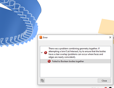

I want to make evenly spaced alignment markings on this bend. I've made a sketch and extruded the marking into the bend. When I create the pattern two marks are missing as shown below. Any insight on why this is happening or a different way to accomplish this would be appreciated.
The extrusion depth is more than long enough.
Supression is NOT on.
Changing the pattern compute type to Identical or Adjust causes failures.
I've tried the extrude and pattern several different ways to try to find a way that works.

That is indeed weird.
It doesn't work with the “face” option either.
If you create the profile as a new body and create the pattern from it, it works.
In my opinion, however, this should not be the case.

Hi! This is a geometry-specific modeling bug. It has something to do with the tip of the triangular extrusion touching the circular edge. It should have work but. For some reason, the Boolean operation fails in certain pattern instances.
There is a simple workaround to make it work. Just move the circular side face outward a bit so that the tip of the triangular extrusion intersects the circular edge. Then the pattern will work fine. Please take a look at the attached file.
Many thanks!

New bodies do not rely on the intersection of the triangle and face.
Here is evidence the edge/face relationship is problematic. I can't get it to combine bodies. This is a known limitation in the shape manager kernel.
Moving the face shows it's not really a cylinder (except at a zero point on the plane)
All of that said, moving the face down to avoid the complex zero point intersections (edge to plane and triangle to that edge), the modeling kernel still doesn't like the number 72.

I'll send this to the team that works on pattern. There's something interesting here. It doesn't like 72. Change it to 73 or 71 instances and it works correctly.

Yes, same with 36.

I forgot about this side project for a bit and the notifications must have been filtered out of my inbox. I ended up making the marks as new bodies, which does work even if it's not desireably, I've tried to combine all the bodies but that operation also fails in the same place depending on how the mark geometry is changed.
