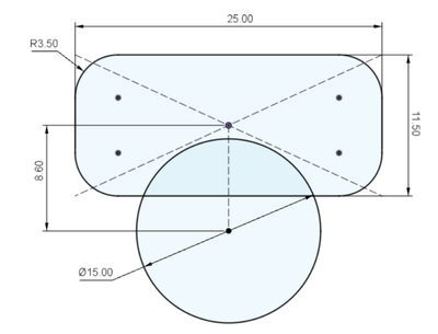

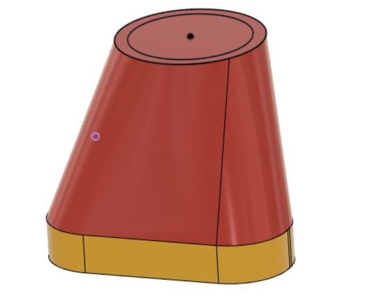

I'm trying to create a loft between two profiles (a circle and a rectangle with rounded corners) using a spline centerline. My issue is that, even though I've selected a centerline, it still creates another rail on the side. And unfortunately I can't seem to move that rail to when I'd like.
Here's the issue:
I tried to edit the loft and drag the rail's position:
But then after clicking 'Ok', the rail returns to the wrong position:
How can I fix this? Please see the problematic Fusion 360 file attached.
Thanks in advance!
Julien

It's not a guide rail, just where the face(s) meet.  Set Visual Style to Shaded to not show it.
Create an offset plane somewhere in the middle of the model, then Project/Intersect to a sketch on that plane.  You'll see there is no actual break on the side:

If you really feel you need the seem in the middle of the edge you can get it done in the surface workspace. I think it does produce a slightly different shape, see attached file.

Thanks @HughesTooling. This is really odd. Even when I use the surface loft tool, the seam doesn't land in the middle of the rounded rectangle's side edge:
Also, the reason why I'm trying to lined those up is to guarantee that the resulting shape is symmetric. Otherwise, it looks skewed as you can see with this section analysis:
Am I missing something?

The curvature comb doesn't look too good either:

Starting with a rectangle, then filleting the corners after the loft appears to give a symmetrical body with a good curvature comb:

Strange, you did try dragging the seam to the midpoint?
Another thing I've tried that lets you pick any quadrant on the circles and midpoint on the obround is break the circles into 2.
Now you can use the solid loft and pick any quadrant on the circle.
The cross section look symmetrical with the seam here.
