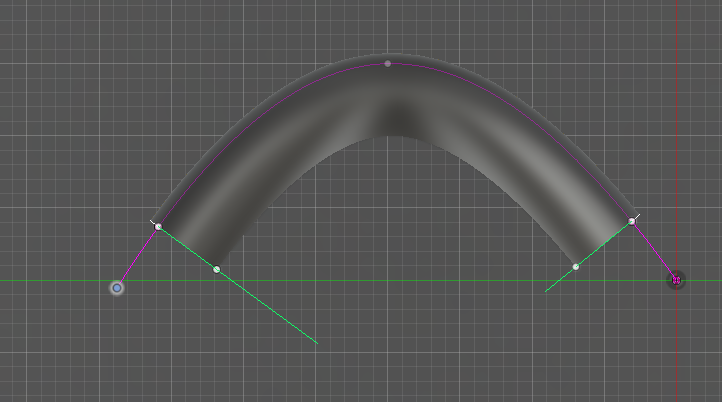

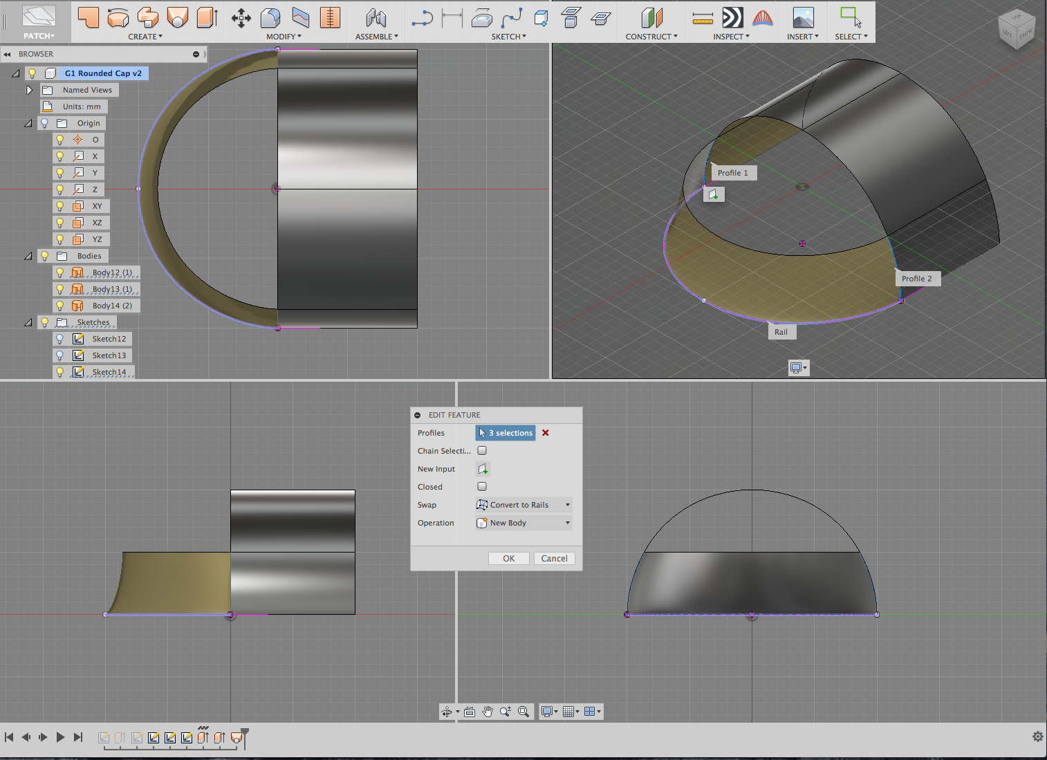

Issue: Loft Rail Inverts surface flow
cekuhnen
at the mid point the surface bends incorrectly with rail option

It's not incorrect, it just doesn't have enough information to do what you want! 😉 (it's not a sweep).  Looks like choosing centerline option gives desired result, I'm guessing due to centerline meaning that it must be at the "crest" of the surface curve.  For rails, would need at least another probably to give it a better idea what want.

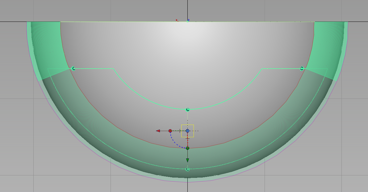

The loft in Fusion (I'm not familiar with other modeling programs) uses some sohpisticated wizardly to determine a good curve to connect between two profiles.  The cross section of the curve as it moves from the first to second profile is not forced to keep the same geometry as does a sweep.  As the loft is moving from one profile to the other, it's trying to figure out how the paths of the points along the first profile are going to ultimately match up with points along the second profile (hence that line that appears with lofts that can be adjusted to redirect profile to profile mapping without using a rail...or multiple lines that appear if profiles have multiple sharp corners).  Rails dictate explicitely how a specific point on one profile is to map to a point on the second profile (as well as the path followed in space from one end point to other), and then the loft region adjacent to the rail is extrapolated from that information in some way.  Due to this, it's sometimes important to choose well what is going to be profiles, and what is going to be rails.  So with the method you are trying here, I tried adding another rail, but can see the difficulties 😉
It's not extrapolating well, so best to choose another method.
My guess is the centerline rail option for this method works well, because it gives the extrapolation algorithm good information, specifically that if you had an imaginary duplicate surface mirrored about the centerline, that the two would have either G1 or G2 (not sure which) at the centerline.

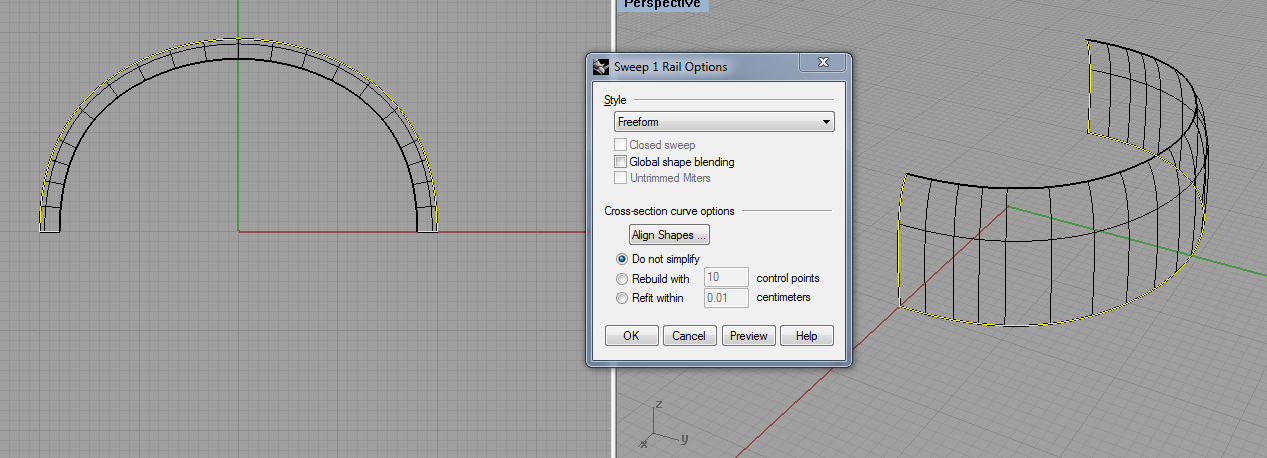

In Fusion they kinda mix what normaly is a loft with rail functions.
And then they offer a sweep one rail command.
But a one rail 2 profiles command should work like moving the profiles along the rail
here is it in Rhino

I've been doing some development on the Loft algorithms used by Fusion recently.  I think differences in terminology between Fusion and other applications may be causing confusion here.
In Fusion, Sweep makes a surface by sweeping a Profile along a Path (no surprise there!).  The surface's cross-section keeps the same shape as the original Profile.
The approach used by Loft is fundamentally different from Sweep.  Loft makes a surface by covering the framework of 'Sections' (both Profiles and Rails) with what are known as Coons Patches.  Mathematically a Coons Patch doesn't see any difference between a Profile and a Rail - they're both just Sections - although of course Fusion does handle them a bit differently (for example, a Loft must have at least two Profiles, but it can have one Rail or no Rails, and the Profiles may be non-G1 but the Rails must be G1).  This means that you can't expect cross-sections of a Loft to stick to the same shape as its Profiles (or indeed its Rails).  (If it helps I'm told that Loft in Fusion is quite similar to the Rhino NetworkSrf command, although I'm not a Rhino user myself.)
And then there's Loft with Centerline, which is different again.  That can be thought of as a sort of hybrid between Loft and Sweep.  The Profiles are swept along the Centerline, but with the surface's cross-section morphing between the shape of one Profile and the next.
For your example above, the ideal operation would be, as you say, a Two-Rail Sweep - but that's not currently something Fusion supports.  Lacking that, normal Sweep and Centerline Loft both appear to give useful results in this case.  However Loft (with Rails) simply isn't guaranteed to give a surface that respects the shape of the Profile in the way you want.

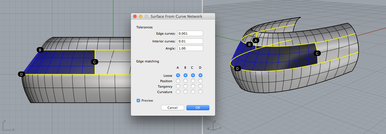

So if one wants to see it that way then Loft is maybe similar to CurveNetwork in Rhino.
There you select your profiles (boundary edges and if present profiles inside the future patch) and then create a surface
with those profiles and define how aling the boundary the surface with flow into the neighbour surfaces.
This is the original form - I split the center surface to create the red window
CurveNet with G2 settings note center area blends well
all edges are positional and center area is linear not inverted like it is in the Fusion file
And here with internal network profiles - the main reason to use curve network

Rhino Sweep 2 Rail can only offer SC aling the rails but not the start and end profile even if that is part of actual sufaces.
I keep the sweep open so you see it better.
So this brings up some interesting questions or suggestions: are the current namings good and or could the functionality be improved.
Fusion sweep can only do one rail one profile and has no SC ability making it more or less an extrude along path command.
Fusion loft that can work like a loft or sweep 2 rails where SC is only possible along the profiles not rails making it not work like surfnetwork.
Rhino can do a sweep along one rail - it can blend between two profiles alone one rail - it can blend two profiles along two rails
Rhino CurveNetwork can SC to all boundary edges
I am not sure if Sweep should be or could be renamed into Extrude along Path

Thanks Claas!  That's interesting stuff.  It does seem that Rhino's "Surface from Curve Network" is very close in principle to Fusion's Loft (using Rails rather than Centerline) even if they don't give quite the same results.
Taking a closer look at the loft in your original example, the 'inverted' surface shape does seem to come about because the algorithm views that as a good way of connecting the profiles and rails.  In particular, it seems to be trying to connect the two profiles as directly as possible, and that's pulling the surface inwards.  Adding a middle profile (as in the picture below) gives the algorithm a much better idea of the overall shape you're trying to achieve in this case.
