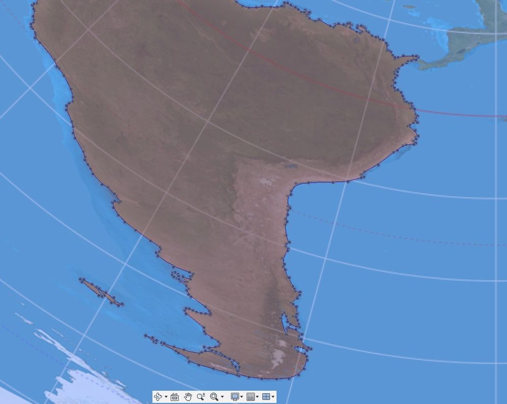

SouthAmerica.jpgSouth America took about 10 minutes to rough in with a Control Point Spline.  This allows you to fine tune it.  With a little effort, you should be able to make a much better design than with that .svg.
On the CAM side, since Fusion 360 recognizes it as a closed boundary, you can create the toolpath for each closed boundary with one click.
Create the latitude and longitude lines in another sketch. Project the continents, islands, etc. from the first sketch.  Use these to trim the latitude and longitude lines.  Delete the projected geometry when the trims are complete.
Note: The image was By Strebe - Own work, CC BY-SA 3.0, https://commons.wikimedia.org/w/index.php?curid=16115152
p.s. In order to eliminate the control points, I extruded the closed boundary areas, then created a new sketch and projected them.  This gives nice clean boundaries for CAM.

@etfrench - did you create South America as a single spline, or more than one connected spline?  I've found that once you get past maybe 50 fit points or slow, the performance suffers.  So, I tend to do these things as several connected splines.  Your mileage may vary.
Jeff Strater
Engineering Director
Message 15 of 17
etfrench
I just clicked away until Fusion 360 ended the spline.  It took three splines to do the continent.  I didn't notice any performance issues.
@Bstarcraft2:  Your .svg file will create an 80mm diameter disk.  At that size it may look OK.
