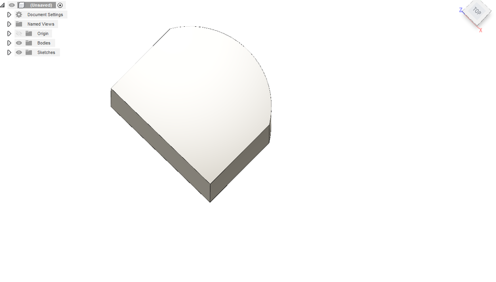

Hi all,
I find myself wanting to find the centre of faces that are irregular polygons or have a mixture of curved and straight sides, and I am wondering if there is a better/easier way to find the centre of these faces rather than drawing a bunch of lines and doing lots of maths. It has been suggested to me to use the align tool to find the centre of these faces however I am wanting to use the faces as references in a sketch rather than wanting to align components together.
I came across this tutorial on how to easily find the centre/centroid of any face in Inventor. Is there an equivalent method of doing this in Fusion 360 that is this quick and easy? I would love a method that I could use on virtually any shape.
