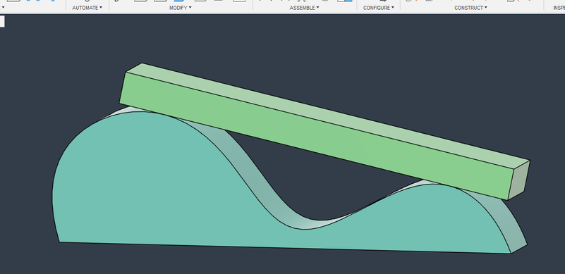

I just tried another workaround that as far as I can tell, develops a true tangent relationship with a spline feature.
I created the top component, and used two "Tangent Relationship" constraints under the Assemble tab. It was a little finicky, I had to roughly position the top component before applying the constraints. Might have worked a little better if I modified the bottom surface of the bar into two separate coplanar surfaces.
Sample size of 1 so we'll see how it works in other situations, but this might be a viable option.
Message 18 of 18
bwalker145
@Art5
I tried this last method on your file and think it worked well. Take a look, should be a true tangent-to-splines line.
