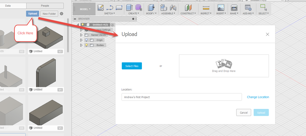

Yes, .STEP files can be opened directly or mass uploaded to your project.
To mass upload, click on Upload then either select the files or drag and drop all of them at once.  FYI - if you drag and drop the entire kit of parts at once, do it before you take off to lunch.  🙂
Let us know if you run into any issues.
