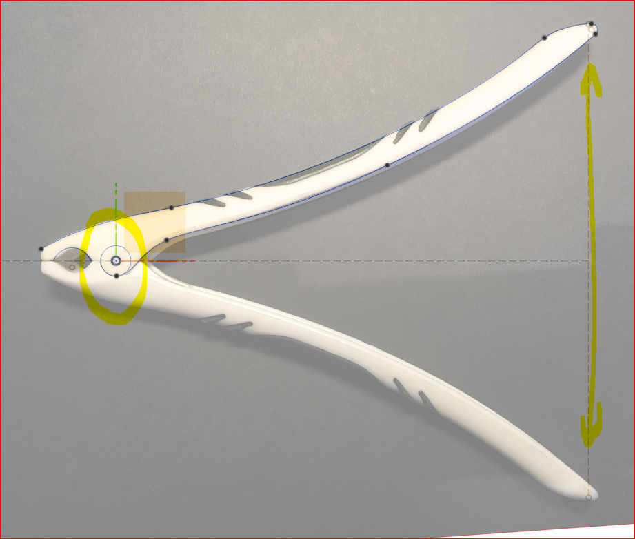

Fusion 360 newbie alert.
I'm trying to recreate a two legged curved clip. I imported a jpg and traced the outline but the lengths, arcs and radii are coming out different for each leg. I'm thinking because of parrallax.  What I think would be best if I traced the top leg *(x-y axis) along a construction line and then flip or mirror the top leg to become the bottom leg, thereby having both legs have equal lengths, arcs and  radii, which would form one single part.
I've done the first part but I'm stuck on the second (flipping or mirroring)part.
Thanks in advance for any suggestions or help.
Tom

davebYYPCU
Your on the right track, but it's not a beginner model.
That Canvass is as good as they can be, and tracing the outline is a start.  If it were me, build one part, then mirror it, cut the hinges detail later.
You will find it better when you use a logical Origin, so mirror can be used with the origin planes,
I have realigned the canvass to the hinge pin, placed the end of the arms in a vertical alignment, and will be as accurate as can be.
Might help....

davebYYPCU
The next thing is to realise there are broadly two mirror functions, sketch and modelling, sketching is not the better of the two.

g-andresen
here is one model.
First I made a sketch for the base body and the cutout.
Then I only used symmetrical extrusions and cutouts for the base body.
Check  timeline and browser for better understanding.
regards
günther

Message 12 of 16
tandd77
Thanks for your response.
I've been trying to figure out everything you did in the supplied file using the timeline.
What I can't figure out is how to modify a sketch before the extrusions to have the two "clip ends" meet when the clip is closed; I added a torsion spring between both parts and they do not physically touch. I drew a construction line from the center of the pivot hole and both of these ends should meet on the construction line. Using the timeline, I have been trying to trace my way back to the sketch to add more material so these points will touch; but I have been unsuccessful.
Any hints or help would be appreciated.
Thanks in advance,
Tom

davebYYPCU
We need your file, pics or screencast to understand your statements.
File > Export, Save to your hard drive and attach it here.
If you traced the canvass, then the jaws will close correctly.
Back when I reviewed the question, there was no mention of the spring, but it can be simulated / animated with Joints and rest positions.
Might help....

davebYYPCU
You file has the pivot pin position, lower than the jaw, can be fixed by editing the sketch. and fixing the shape.
Find the correct sketch, right click, and edit Sketch is in the menu.  Finish / Stop Sketch will do the updates.
I did not find any work for the spring in that file.
Best way to decipher a file, is with the playback tool, from the beginning, one step at a time, and using the lightbulbs to help see or not the clutter,
any time you can Right click a timeline icon, select edit feature to see the settings in preview, then cancel.
I have animated the clippers in my file,
Select the Joint, - Rev5, right click and select Animate Model..
Might help....
