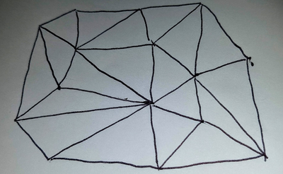

I have a sketch that contains a triangular grid consisting of points with dimensional constraints between them to set the spacing. The triangles vary in size as I created it by surveying a plot of land using a tape measure.
I would like to make this bigger, actually a 1000 times bigger as I picked the wrong unit "mm" instead of "m".
As far as I can tell using the "modify > sketch scale" feature expands/contracts the distance between the points but erases the dimensional constraints instead of scaling them by the scale factor.
I tried using the "Modify > Change parameters" feature but that results in multiple calculation errors. Presumably to make this work you have to manually do the changes in an order that doesn't cause any constraint violations? Is that right?

The problem can be seen as follows:
- Create new sketch.
- Create 3 points some random distance apart from each other.
- Apply dimensional constraints between point 1 and 2. point 2 and 3 and point 3 and 1.
- Scale the sketch using point 3 as the origin.
The constraints no longer exist.
The Change Parameters box works for simple things such as the above 3 point scenario, but once you add lots of points forming lots of constrained triangles looking something like this https://i.imgur.com/FYzbaL5.jpg ,all you see is a list in the order they were created. What you need is to see the outer most points listed first as these are the only ones that can be safely modified without causing constraint violations.

The need to rescale at the sketch level is because I'm trying to copy and paste a bunch of point and constraints from a sketch that has dimensions in meters into another sketch which is (incorrectly) using mm and therefore there is a 1000 fold mismatch.
