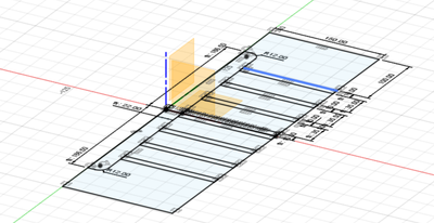

I have the complex sketch below which I want to extrude all upwards so the entire sketch has a certain thickness.
But - as expected - a new body is extruded with none of the lines and closed profiles from the sketch preserved on any of the shape's faces.
What's the most efficient way of extruding the shape while preserving the lines and profiles on the new body's top face?
I'd like to shy away from simply copying sketches if possible because from my experience, there are always things out of whack in the pasted sketches, such as the need of constraining parts over again and also things simply being out of place (like the below picture). But If there isn't an option anymore efficient than this though... Oh well, it was worth a shot.
