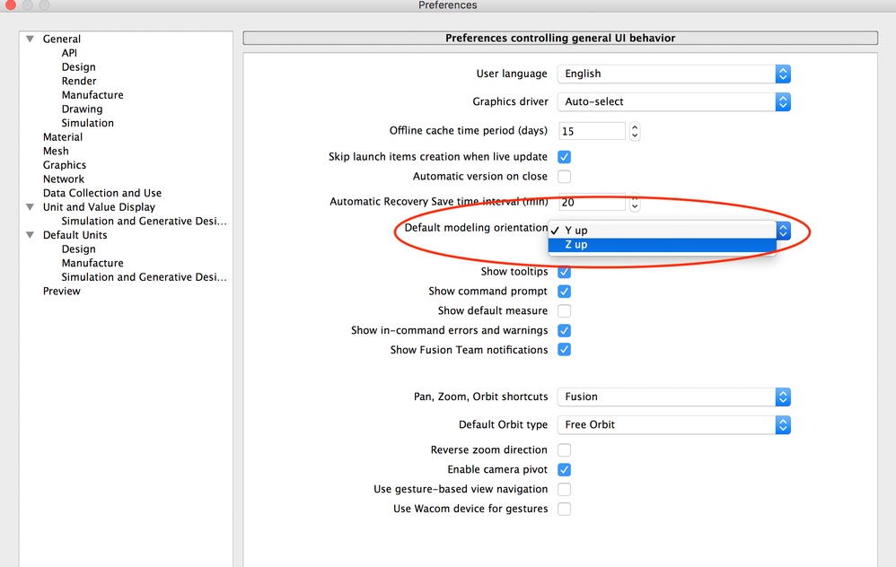

Greetings,
Im not too sure how to word this as Im not too familiar with the proper terminology. But I use Fusion to model for 3D printing. Where Z is up and down and X is left to right. When I model on default and save, I always have to rotate my print in my slicer program because by default in fusion Y is up and down.
Can I change it so my front view is with Z up and down in stead of the default Y up and down?

yes, this is a preference.  You can set it here:
