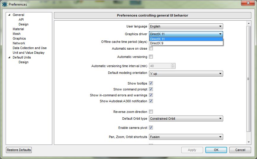

After a lot of trials, re-installations, question to Autodesk etc. I'm still unable to get a view on a sample...
See screenshot , no part is visible , no grid or whatever is visible. What should I do?

Hi, yeah, that's weird all right. Sorry you are having these problems.
Can you post a screen shot of the browser expanded? Is there some way that everything is there, but invisible?
Also, if you create a new design, and add primitives, do you see anything?
Did you get any warnings about your graphics card when you invoked Fusion? What kind of computer are you using, and what are its graphics capabilities?
Finally (and I think this is a desperate shot in the dark, just try the "fit" command (bottom of the screen):
just on the off chance that the stuff is there, but not in the view...

harriebouwens
Jeff,
As You see in image Fusion3, the background is grey at start up. Loading an example doesn't change the background
Neither the  new body command changes a thing, neither the buttons at the bottom are clickable.

Please open your preferences menu:
When the preferences dialog comes up, please change your Graphics Driver from DirectX 11 to DirectX 9:
Click OK and close and restart your application. You should now see all the graphics. If you have any further issues please let us know. Thank you for your patience.
Message 5 of 11
harriebouwens
It was the solution, but where could I have found this?
Message 6 of 11
mccoym
I'll get it added to the Fusion Readme. Other than that, the Forum is a good place to go to and post your issues. We try to address them as quickly as possible. Thanks!
