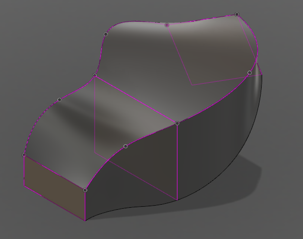

By using those curves as rail curves in the loft, this is the result you get:
The rail curves allow you to change the shape of the body in between the profile sections.

Reviewing our earlier Loft with rails example, this time with the profiles and rails visible:
The rails are indicated with the red arrows. The thing to notice here is that the Loft body follows those rails exactly. So, the difference between centerline rail and “precise” rail is this: Centerline rails affect the shape in a general way, while precise rails affect the shape in a very specific way: The body is constrained to follow the rails exactly.
