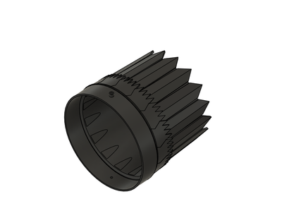

I am new to fusion.  This is my first project - a F-35.  Crazy right!
When I attempted to create a mold of the fuselage, the interior bomb door hinges are part of the mold.
If the cut operation was the external skin, why did the hinges get included?  How can I correct this prior to printing the mold sections?
I have attached a fusion file that has the 3 bodies in question.

gregevansphoto
fusion file attached
gregevansphoto
Thanks for the reply.
I have attached a fusion file with the fuselage and molds above.
I used the mesh file as a basis for the rest of the model.
I have modeled the interior structure shown below.
In addition, I modeled the vectored exhaust port
I intend to make a composite skin and use the internal structure above as the mold for the composite.
That is when I ran into the issue of the hinges being visible on bottom mold.
If I cannot get a solution on how to remove them, I will just print the sections and do it the old fashion way - cut, sand, fill, primer.
gregevansphoto
I found the only way to fix this issue was to go back to the mesh and do a direct edit and delete the unwanted faces.
