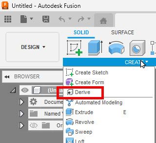

If and when Intent Driven Design is implemented there is a problem with using the Derive function when used to insert "only" parameters into an existing design.  It will only work if the model has at least one other feature such as a sketch or body.  It will not derive just parameters into an existing design.  This feature is very important in the design process and works perfectly when the Intent Driven Design preview is not turned on.
