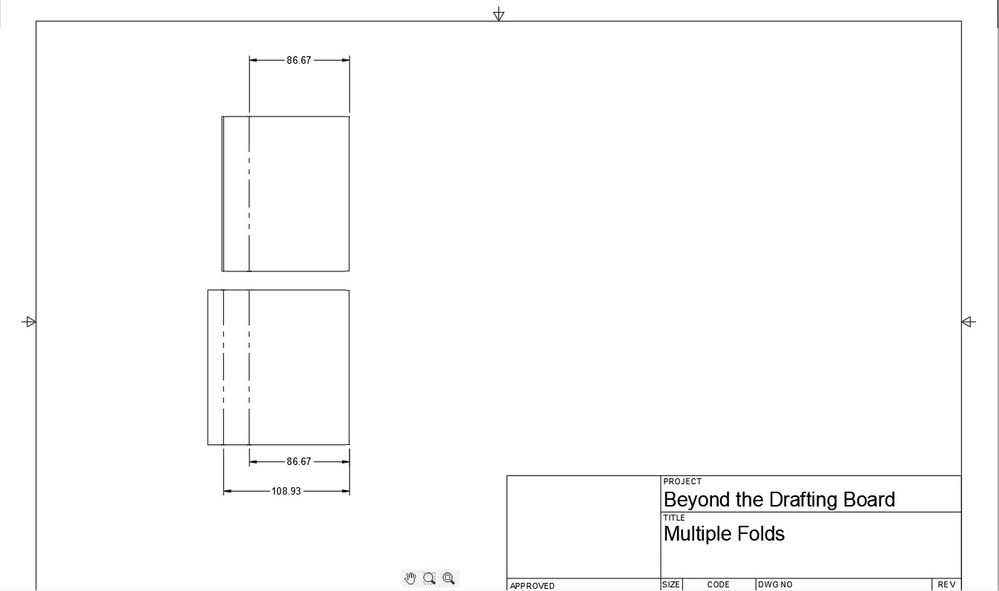

Using the Unfold command, you can make partial sheet metal body unfolds.  This command allows you to select one of more bends you desire.  You can then add a manual bend line easily with a simple sketch.  You then save them out as individual files.  You can them assembly them into an assembly and add dimensions from a common edge.  This process is not easy but it does what you asked, partial unfolds.  Below is a simple sheet metal piece with the an drawing example.

I see what you’re saying. I knew I could use the unfold command in the design workspace, it just seems to me like the drawing workspace could really benefit from having a similar command, or a way to add a partially unfolded piece to a drawing sheet like there is for flat patterns. In the particular instance I’m in I cannot reference off of a common edge as you have shown because there are features there stopping me from bumping that edge to the back-gauge, I need to reference off of the folded edge. I could absolutely still do this using the workflow you’ve laid out as well, it just seems… tedious.
