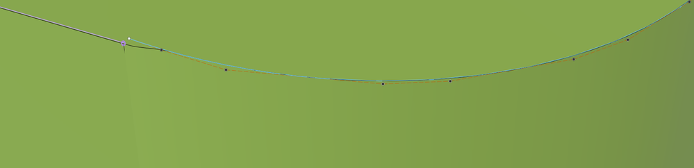

Hi there, i've noticed on several occasions that when you include an edge from a 3d object the resulting curve is not always exactly replicated. Here is an example from a model that was created using a network surface patch. The model is a bit dodgy in places but it machined without problems that can't be sanded away. I presume that the cause of the wrong spline creation is because of the dodgy/kinky surface on the rounded corner but i still don't understand why that would prevent Fusion from creating this edge as it is on the model and as i can select it.
Here's what it looks like when this happens, the red outline and blue curve is how Fusion generate the 'included' edges of the geometry:
I've attached an example file to play around with (the issue is the edges connecting to the rounded corner). I've tried some workarounds but even unstitching the model doesn't help whereas i though that at least on a single unconnected face the edge should be 'included' as is, even if the face is somewhat twisted.

Looking at the curvature combs confirms the "dodgy" nature of the geometry. Usually that sort of geometry is the result of inadequate modeling techniques and it isn't a surprise that such bad edges don't project well onto sketch curves.
If you can share the complete model with timeline we might be able to identify the root cause.

ge witin some internal tolerance and I cannot answer the real reason for that, because I have no insights of how those algorithms work.
What I observe is that Fusion 360 approximates that edge with a control points spline with some number of control points. You can see that spline when you "break link" and make that sketch curve editable (but loose the parametric link to the edge).

the short answer is:  @TrippyLighting is right (which is usually the case...).  There is an approximation step, even when "including" an edge like this.  A sketch object is a different data model object from an edge.  That is an implementation detail that you shouldn't need to know, but that is the underlying reason.  Most times, Include is pretty accurate.  I don't know, in particular, what the cause of the inaccuracy here is.  Peter's theory about curvature of the edge is certainly a good guess as to the cause.  We do have a project, somewhere in the backlog, to try to improve the accuracy of these operations, but, as you can guess, there is a tradeoff here - more accurate usually means more control points, which can lead to its own set of headaches.
One question that I don't think has been asked here is:  What are you intending to do with the included edge?  Many times, you can reference the edge directly, without having to go through a sketch.  For instance, a sweep path can be a set of connected edges, it does not have to be a series of sketch curves.  That will be 100% accurate, since you are referencing the edge directly.   There is no approximation.  Of course, that doesn't help in all cases (which is why Include is there in the first place).

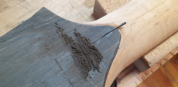

i am trying to make a clamping caul for glueing an ebony backstrap to a guitar headstock. it's a really tricky part to glue which is partly due to the geometry of the back of the headstock but mainly due to the problem of heat bending the ebony acurately and asymetrically and the fact that i work with hot hide glue which doesn't have a long open time so i need to move quickly. i've been doing this for quite a long time so it's not a show stopper when things go wrong but i'm always dreading the glue up and i've tried a variety of techniques for making a clamping jig so now i'm trying to make one in Fusion.
Here's what the final glued up version looks like and because of the clamping/heat bending problems i cracked the backplate ... again ... (which with ebony isn't really a problem and easily repaired with a splint and sawdust for an invisible fix)

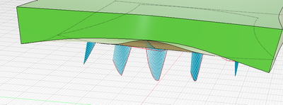

i attached a file with the clamp i modeled by converting the backface to a tspline with the curvature option set really tight and then thickening it and cutting of one side straight (i need the top of the caul to be a flat face so the clamps will hold). i haven't machined it yet but the problem i see with this model is the downward drooping bits:
which will break the plate again when i clamp it since the part i'm glueing on is a bit oversized and the downward pointing bits will for sure crack the ebony plate. it would be necessary for the continuation of the clamp caul to continue in a straight plane (not sure if i'm explaining this well).
i think the main problem of all this is that the upwards slope is not symetrical (because of the asymetric headstock design) and the fact that i modeled a bit of a spine into the middle (to add a bit more strength to the headstock). The spine/raisedmiddlebit doesn't really do much so for the future i'll probably remodel this with a flat curved plane:
