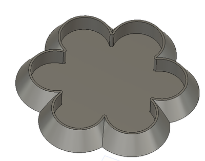

Hello guys,
I didn't made any new post in the last few months as I didn't had any problems with the models I needed to mill, but today was not my day, I also got a cold, so nothing helps today, not the mood, not the model .. nothing...
I first tried to make the blade at 30 degree angle from the original DXF, but I got some weird geometry errors where the petals are joined, I than tried to smooth the original dxf using CamBam, it did not work either.
Next step was to redraw the shape using Fusion, I used splines tool.. but I couldn't make the wall at a 30 degree angle.
I tried once more, using a 3 point arc, I rebuilded the flower, even if there was a small difference between the original dxf and the resulted drawing, it's not an issue. This time I had more luck, I could make the draft but only at 29 degree, if I tried to extend it to 30 degree the draft wall was not created at all.
One more issue with my last drawing is the it created an error in 3D model only between 2 petals, all the other are perfect, but 2 petals generated an error , as you can see bellow :
Any idea what is wrong, how can I fix the resulted 3D model , to have the wall at 30 degree, and also have it joined between all the petals ?

g-andresen
is it this, what you are fighting for?
draft_problem.pnggünther
*You´ll find some values in the parameterlist.

TrippyLighting
This is all about technique.
First I moved the shape in the imported sketch o the center using the move tool.
Then I only sketch 1/2 of one petal, so with 6 petals, I only sketch 1/12th of the entire shape.
I use 2 3-point splines for the curved parts.
Then I extrude, mirror, combine, pattern and combine all this into a single flower shape.
With that geometry drafting to 30 degrees is no problem. Model attached.

chrisplyler
Are you TRYING to make this thing asymmetrical? I added some construction lines to your sketch and dimensioned/measured some things. No two opposing petal intersection points have the same distance between them. There is no common center point. The outside curves of the petals are made of various spline and arc segments that are all different. No two petals are the same. It's a mess. Is that what you WANT?
Assuming that you want something that is symmetrical, why would you try tracing over a DXF by eyeballing it? Maybe try it kinda like this:

When I tried to redraw the sketch in fusion, I always tried to make a perfect copy of the client's dxf, and this is why I ended up using splines or arcs with many nodes, the secret is to use less nodes, I made the smaller flower just now, using @TrippyLighting and @chrisplyler technique, it didn't took more than 5 minutes to have a full flower ... so easy..
bellow is my progress with the big flower, all the roughing operations are done. now I start the sharpening of the blade, the tricky part is between the blades, on the exterior side.
