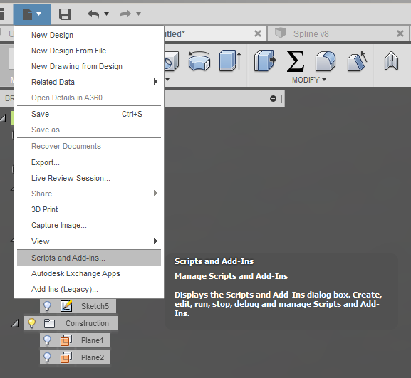

Have you experimented with the gear scripts supplied with Fusion.
Also see this thread for info on using the script
