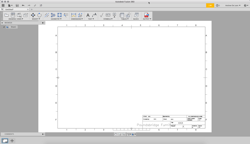

I'm trying to import the following DWG custom title block into Fusion 360 and having no luck at all. Nothing appears when I try to import. Any assistance would be greatly appreciated. Thanks

Sorry you've had trouble with this. I took a look and there was 1 block in the drawing so this should have displayed a warning and prevented the insertion. And on a closer look, it was 25.4 times larger and 0,0 was somewhere far off the bottom right corner. So I exploded the block, scaled down by 0.xxx-xxxxxxxx, and move the bottom right corner of the border to 0,0 and it came straight in. So try the attached file and let me know if you're still having problems.
Just curious, in what product did you create your DWG file?

Really appreciate it Andrew. I was using Autocad 16 for Mac but had downloaded a starting template and was modifying that one. To be honest I have almost no experience with Autocad so it was a bit of fumbling around in the dark. Cheers
