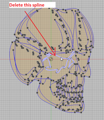

Maowen_Zhang
@Anonymous, @HughesTooling, thanks for sharing the issue with us!
We checked that I could snap geometry to the imported splines, and the sketch profiles also shows up. Is this what you see? If not, could you provide some more info about it?
If you do can't see the profile, could you try delete the special spline as below to check whether profiles show up?

HughesTooling
The problem is you can't edit the splines. If you edit the sketch and click on one of the splines you don't get any handles to make modifications. Also the points on the spline don't do anything, if you find the end point, point you can move the spline but moving the other points on the spline has no effect.

HughesTooling
I imported the file into Rhino, exploded the curves then exported as DXF and now it works, it looks like Fusion doesn't like joined NURBS curves. Fusion file attached.
