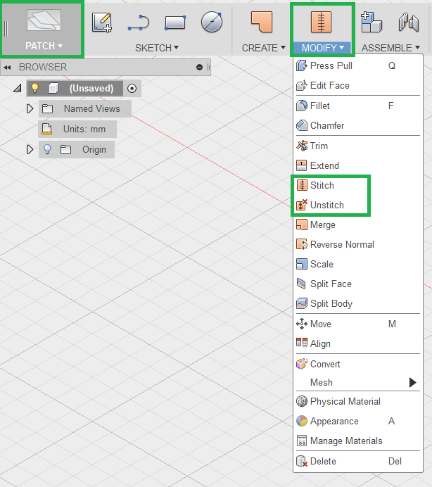

From experience I would suggest to export a *.step and repair it in Fusion
There might be an easy fix to create a watertight model once you import your step file:
  1. Just go into the "Patch" environment
  2. Select all faces and edges and use the "Unstitch" feature
  3. Than, select all faces and edges again and use the "Stitch" feature
  4. Now you can you use the "Interference" and "Validate" feature in the "Inspect" ribbon to check the quality of your design

I know that a lot of CAD systems give you a couple options before importing a file. This would be the
"Validate" and "Interference" function which would point to the issues in the file.
You would repair your model half manual and half automatic by using "Stitch","Unstitch", "Merge" and "Split face".
