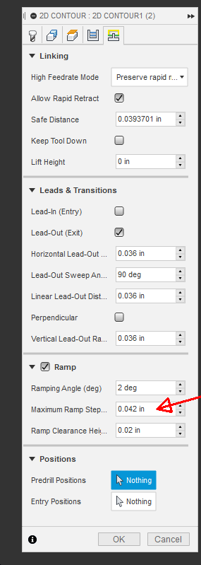

I don't see this available in the various dropdowns. It's a one off (camera adapter for my telescope thread).
I'm assuming I have to get the calculator and crunch the numbers.
If there is an easier way that would help a lot.

OK, so I crunched the numbers and did a ramp in 2D contour. Problem is the ramp angle kept being 20% too shallow. I did and redid the numbers. No luck.
I used Simulate and observed the actual Z depth in 1 revolution and increased the ramp angle according to the ratio of intended to observed Z per revolution and I can make this part now.
I have no idea why that ramp angle discrepancy exists.

To clarify, I lied to Fusion. It wouldn't accept a threading tool for a Contour so I said it was an end mill with the diameter of my threading tool.

Just remembered there's an easy way to do this, set the maximum ramp step to the pitch and the angle can be anything as long as it bigger than the helix angle.

I don't understand, I set the maximum ramp stepdown to 1 inch knowing my thread is only .3 inches so the ramp would be continuous, making the thread.

Have you tried with the settings above? The max ramp step is the max depth of cut and the angle is adjusted to match, so all you need to do is enter the pitch as the max ramp step.

I see my error now. I'll give your idea a try. The part is done and accepted by the customer (me), so I'll have to make another blank for that.

Didn't have Fusion running earlier but I've attached the file. The max ramp step is quite useful, if you have a long ramp and set the angle to 2° you could end up taking a very deep cut, so you can set it to say 5mm and the ramp is adjusted so you never take more than 5mm.
Also did some checking and you had your trig wrong. Here you can see the helix angle for the od of the thread is 0.3799 and the helix angle for the centre of the cutter is 0.46334879. Not sure how you checked the toolpath but I used the simulation with points enabled and measured between points,
