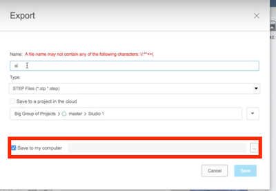

I would like to export my design as a .stp. When I try, I get the message, Translator failed to export the asset as file: "/Users/christian/Desktop/Beacon Knob Bottom v1.step". I thought it might have been an issue with the design so I tried exporting a different design. I got the same error. This happens with every one of my designs. (I have exported many times before FYI.)
This is the Error message in the lower right corner, Error: boost::filesystem::copy_file: Operation not permitted: "/var/folders/yt/1dbk5dzj5rgg4w248sb24h700000gn/T/com.autodesk.mas.fusion360/Neutron/45b49cd6-180f-4a1e-9e82-199ae3f07b6b.stp", "/Users/christian/Desktop/Beacon Knob Bottom v1.step"
If I try to export my designs in any other format, nothing happens. I never get an export at all. Sometimes, I get an error message but most of the time, nothing at all happens.
Also, I have cleared the Cache data under help multiple times. I have also restarted my computer a few times over the past few days. I am using version 2.0.4262

That was a good thought so I tried it. I did a full clear and reinstalled it twice. I now have a new problem. When I go to Export, I see a red message on the export window. The message says, A file name may not contain any of the following characters: \/:*"<>. This message is there no matter what my title is.
Basically, I can't even attempt to export now. I have also tried this on multiple designs with the same problem.

I did all of the steps in order and I am still experiencing the same issue. Before today, I downloaded the program from the mac store. Since I still have the issue from a different download source, I was wondering if it may just be a problem with my account. I made a new trial account and created a quick design. When I tried to export that file, I experienced the same issue. I have no idea what is wrong with this thing. I first noticed the issue with the update where the color of the logo changed. The app store show that update was installed on June 15th, 2018. Any ideas?

Hi @Anonymous,
Sorry for the delay. I took another peek at the screencast and I noticed that the directory field looks empty in export... is still the case? From your video, compared to mine on the right:
Screen Shot 2018-06-26 at 12.22.26 PM.pngScreen Shot 2018-06-26 at 12.26.13 PM.png
As you can see, my directory is filled out. If you click the dots and manually choose a spot to save to, does it work?
Message 14 of 16
Yep that worked! Nice attention to detail. Thanks!
