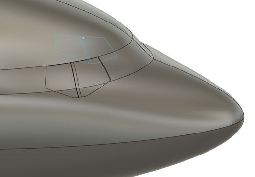

I am trying to turn a complex shell into a thickness of 5mm. I have tried everything but i cant solve it. The design has no warnings so thats propably not the problem. Is there someone who maybe could help me out.

@carlweitman50  schrieb:
Hello. Very many thanks to the help. However if you look closely on the top of the window, there is unfortunately an uneven shape. This is problematic because then i cant join them and properly print them. Very many thanks tho, and i would greatly appreciate if you maybe took a look at the problem.
Carl
It seems that this corner makes the part partially unworkable. For example, the shell cannot be split lengthwise.
Forget this body, it's just an attempt to thicken the surfaces by hook or by crook.
I don't quite understand why you can't print without infill. Which slicer do you use?
If you print without infill, the wall must not be thicker than 1 mm. That means 2 perimeters of 0.5 mm each.

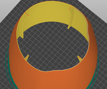

wersy
First you need to cut slots.
I use Prusaslicer.
If you use Cura take 3 lines (perimeters)
And no infill.

Message 33 of 43
wersy
Slicing surfaces is very complicated.
You also have to set the slicer to "Surface".
Message 34 of 43
carlweitman50
yes thanks. However it skips some parts of the design. Is there any way to do it more accurately so that every part of the design is included, considering that there is a former at the bottom of the model with a different thickness than the rest of the model.
Message 35 of 43
wersy
In "Surface" mode, the nozzle only follows surfaces. To achieve a certain thickness, a corresponding number of surfaces must be placed next to each other.
In addition, the center of the surfaces is followed. That means outer and inner surfaces must be offset by half the extrusion width.
And there are many more rules that need to be observed.
As I already mentioned, slicing surfaces is very complicated.
If I can give you some good advice - forget it.

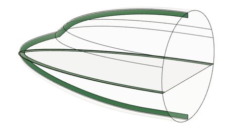

carlweitman50
Yes okay, but i still want the nose. Is there any other way that i can slice it. Maybe making it a solid and then slicing it, keeping in mind that the bottom part is supposed to have a different thickness than the Shell. Please check out the attached file in my previous message.
Message 37 of 43
wersy
You have to print the ring separately.

yes. Now i have tried to slice it as a surface, but all of the slots dont show up, only the vertical spars, but not the horizontal. I have checked that the horizontal spars touch the shell, and i have also tried making it a solid. None of this has worked however, while also keeping in mind of the windows, so that they are a part of the finished product.
Message 39 of 43
wersy
Designing more complex parts in surfaces is something for specialists, I don't count myself among them.
I would do as I have already recommended.
And just move the windows slightly inwards. To do this, the window surface must be split.
Message 40 of 43
carlweitman50
ok. I think i have an idea to solve the problem now. Could you please tell me how you did the slots on the nose cone.
