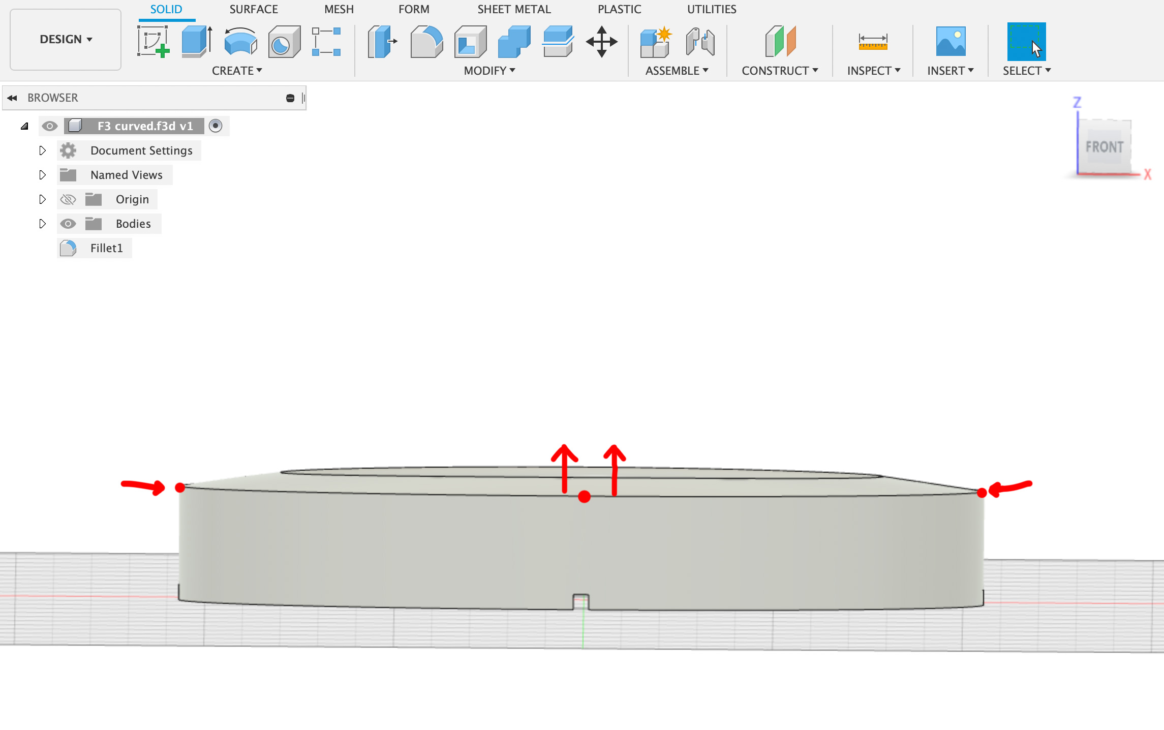

Please excuse my lack of knowledge, but I was hoping that someone will be able to understand what I'm trying to achieve and point me in the right direction...
I have created a design in Tinkercad and exported it to Fusion360 in order to finish it off, however I'm unable to get my head around the right functions in order to increase the height of each side on the Y axis very slightly (by 1.2mm to be precise), without increasing the height on X axis but also still maintaining the relative curvature of the top face.
I've attached a couple of screenshots to highlight what I mean, along with the F3d file of said design.
If there is someone who can shed some light on this for me I would be very grateful indeed!
Thanks in advance 🙂

orbitmansion
Thanks for that, although I'm not sure if that targets the height of the points as indicated in my example pictures?
Again, please excuse my lack of knowledge but I'm trying to increase the height of the outer edges of the top elliptical face by 1.2mm - not the overall width - unless I've misunderstood your explanation!!
I've mocked up an example in photoshop using the warp tool - granted, it's over the top and the final result will be much more subtle in gradient, but hopefully it demonstrates what I'm after.
Thanks again

orbitmansion
Thanks for your reply 🙂
yes, so it's the Y axis that I'm looking to modify, across the whole width of each side. If you take a look at the image, the Y Axis needs to be 1.2mm higher than X Axis (both inside and outside edge) so that it becomes a hyperbolic paraboloid, in effect!
Thanks again for your continued help with this...

davebYYPCU
Like this?  Dark is new light is old.
Might help.....
Message 9 of 9
orbitmansion
Yes Dave!! That's it, thanks 😀
