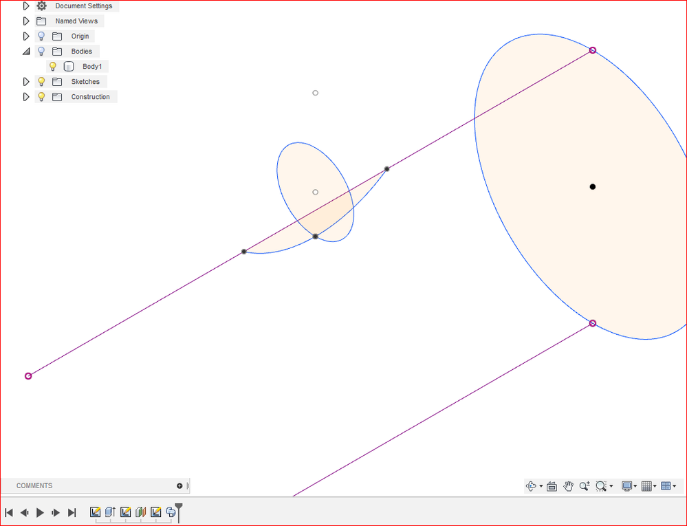

I'm new to Fusion 360. How would you create an elliptical crease (or dent) as the one below on a curved surface  such as a side wall of a cylindrical object?

davebYYPCU
One versatile way, Add dimensions for size
Sweep allows shaped profiles, so not limited to elliptical results.
Might help....
