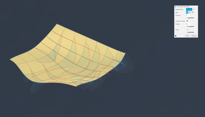

I thought that I add a bit of information that many Fusion 360 practitioners are not familiar with.
These concepts might be particularly helpful for Educators
In CAD software curved surfaces are represented as NURBS. The shape of a NURBS surface is described by a rectilinear grid of control points and associated weights. The key takeaway here is that that gris is always rectilinear.
However, obviously not every CAD surface is rectilinear e.g. has 4 sides.
As such we see on the screen are trimmed surfaces.
What is stored internally, invisible to the eye, however  are the original surfaces and the trimming loops.
To analyze how a piece of geometry was constructed It helps to get back that original surface before it was trimmed.
In Fusion 360 We can get the original surface back (mostly) by either unstitching that surface from the solid boy, or by creating a 0mm offset of that surface, essentially copying the trimmed surface . Then we can use the untrim command to delete the trimming loops and get back the original surface (or in Fusion 360 at least a close approximation):
Then we might use the curvature comb inspection tool on the surface edges to inspect the quality of the boundary  edges :
We can see that the curvature is not smooth ...
Or for a more complete analysis we might use the iso curve analysis with equally questionable results:
