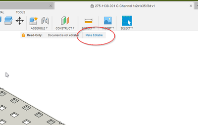

... and I just figured it out. While trying this again, I saw a new pop-up menu at the top that I must have missed before, warning me that the file is read-only:
Once I clicked "Make Editable" and saved it as a new copy of itself, it behaves as expected:
The free version limits you to only 10 editable parts and I was a bit concerned for a moment that all parts in the assembly would have to be editable, but I found out that after clicking "Make Editable", I can still change it back to Read-Only and it still works.
So, the workflow for inserting a downloaded "native" file is to download it, upload it, open it, make it editable, save it as a new copy, then insert it. Wow. I guess it's free, I can't complain too much!
