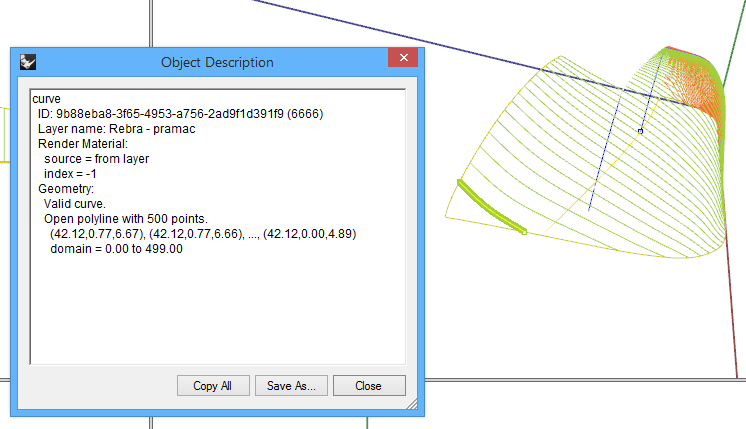

Can you attach the dwg file I'll take a look at it in Rhino and see if I can figure what's wrong. I've found dwg to be very good a getting info into Fusion so there might be a setting for the type of spline that's the problem.

I don't think these curves are going to be something you can work with.
Just this one small curve is made from 500 short line segmants, trying to build a surface off of that is not going to work in any programe I've used.
Is there any way to save as splines of any sort.
Mark

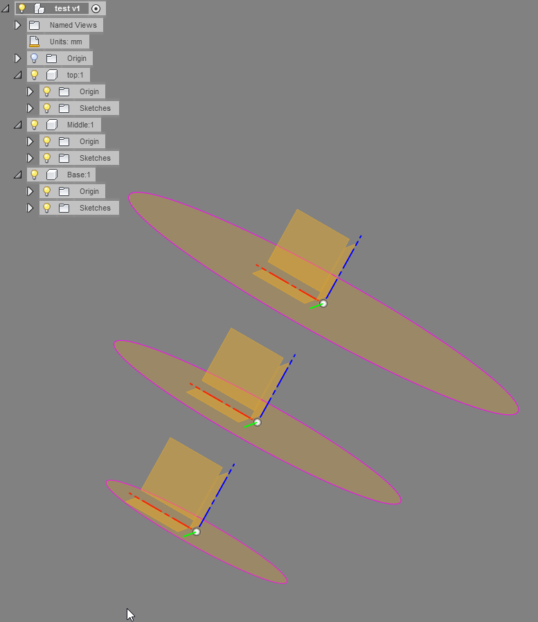

I've been thinking about this some more. Something that could be a problem is even if you put each section on a different layer the sketch will not be at Z0.0.
Here's a simple example with 3 circles, each was on a separate layer and when imported created a sketch for each circle but the origin is the same for all of them. This means they are 3d sketches and this might be a problem.
All component origins are on and at the same point.
In the test below I made blocks and set the block origin at the centre of each circle. This give you a 2d sketch with the origin and circle at Z0.0
I can create a loft between the circles in the first example so I might be worrying about nothing but I thought I'd put my thoughts here.Smiley Indifferent
Mark
