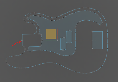

Shortly after I made the post, I started getting antsy and discovered how to use the "canvas" feature. I've attached my work so far.
What I'm having issues with rn is how to "constrain" the couple hundred points from when I used the spline feature to trace the body, pickguard, and pickup outline. I'm not sure how to turn all those into a single line which I can then constrain. I'm waiting on some radius gauges and a square to arrive in the mail so I can measure the angles of the pickups I'm using along with the neck pocket measurements, as well. Any advice so far on the above?

Message 16 of 19
TrippyLighting
Nope, no and no!
I am not sure what courses you've been taking but ...
  1. The first thing you might already have done is to find a reference dimension you can use to calibrate the canvas. Then calibrate the canvas.
  2. Find a reference edge/point on the canvas image to align with the origin. For example the point the arrow indicates would be good to line up with the sketch/design origin.  While it cannot be seen in the canvas image, I am assuming this is a physical edge on the guitar that you can use to reference measurements from.TrippyLighting_0-1636028478604.png
  3. Your splines have too many spline control points, by a factor of 10!!!
    Here is one half of the outline as I would approach it. It takes some patience to manipulate the tangent handles , but it pays off big dividends:
Message 17 of 19
I completed these courses and these courses so far. I just started at the top on this page and am slowly working my way down in the courses that seem applicable to me.
As far as the reference dimension, yep I found that was the thing to do after doing a bit of googling on how to use the canvas function for guitars. I centered it on the bridge and rotated slightly till it was center on the neck, and then I calibrated it to the true width of that bridge. I just went down to the local guitar center and took some measurements from one of those they had in stock. That line you drew the red arrow to is just the end of the neck heel, though. I just put it in there cause it eventually has to be modeled anyway. But whoooooboi, I'm just gonna start again with all the spline control points. Lol. I just got too click happy. After that, I gotta figure out how to constrain them. Would that be done by adding dimensions to the entire body? Or is there a different way I'm not thinking of, at the moment? I think the constraints in the tutorials were done mostly by measurements.

TrippyLighting
@Anonymous wrote:
... I'm just gonna start again with all the spline control points. Lol. I just got too click happy. After that, I gotta figure out how to constrain them. Would that be done by adding dimensions to the entire body? Or is there a different way I'm not thinking of, at the moment?
This pertains to fit point splines only!
Because these splines still have quite a number of points, once completely done and happy with the sketches spline outline I would use the fix constraint to lock them down and prevent accidental movement of spline points when not actively editing the sketch. If you start applying all the dimensions needed to lock down a fit-point spline with 9 points your sketch will become completely clustered with dimensions.
Others might have differing opinions 😉

That was a pretty good learning experience! I've attached the updated version; does it look a bit better to you? I still had to use around twice as many points than it looks like you needed for me to get the angles right, but I learned what those tangent handles do now. I had no idea before.
