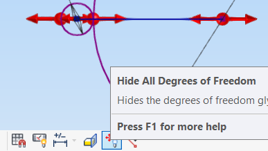

You are also wrestling with a bug in the sketch engine.  I know sketch 10 looks fully constrained (as uploaded, before trying to trim), because all the lines are black.  But it's not.  You can tell because there is no push-pin icon on the sketch in the browser.
I'm able to repeatably get the circle in the upper right quadrent to turn blue or black, depening on the sequence of what I click on.  Definitely a bug.

Ah, thanks for that, @laughingcreek -- I was getting pretty confused by that.  I was finally able to trim in a different order and get it all cleaned up with no blue lines left, but since I am going to be doing the entire thing over anyhow, that was really just some experimentation/practice.

I understand what in going on in Sketch10 in this model.  There are two coincident circles in the upper right hand side of this sketch.  One is dimensioned, which makes it fully constrained, and the other is not.  That's why the whole sketch is not fully constrained (no push pin in the icon).  You can see this if you use Select Other (hold the left mouse button for 1/2 second), you can see the existence of the two circles.  And, if you rotate the view a bit, you can see them "z fighting" with each other - sometimes you can see the pink (under constrained) circle, and sometimes you see the white (fully constrained) circle.  One of those items in the Select Other list is the under constrained one.  Select and delete it.
