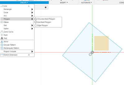

TheCADWhisperer
@vampiro2004
Start a new file
Create a sketch of a 4-sided Polygon centered at the Origin on the XY Plane as shown below...
add the dimension shown...
now add a Vertical constraint between the two points shown.
What do you note about the color of the sketch after adding the Vertical Constraint?
Attach your progress file here (we will go very slow at first and then pick up speed as I see you are following along.

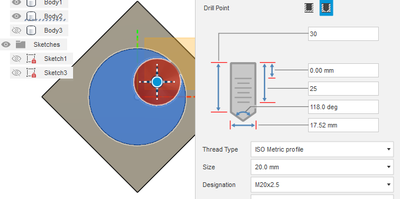

@vampiro2004
Now hide the third body and select the Hole command and then select the top of the cylinder off-center as shown below and set the Options as shown....
Now click the Top view on the View Cube in upper right corner of the screen and then Click and Drag the center of the Hole feature to the center of the circle.
I always click off-center and then drag to center as I have seen too many instances of where user thinks they selected the center but are off by a tiny amount that is hard to diagnose the issue later.
Add a 1.5 Chamfer to the edge of the hole for lead-in.
You should anticipate the next step...
Edit the Hole feature and change the thread to Modeled.
Attach your progress here for next set of steps.
