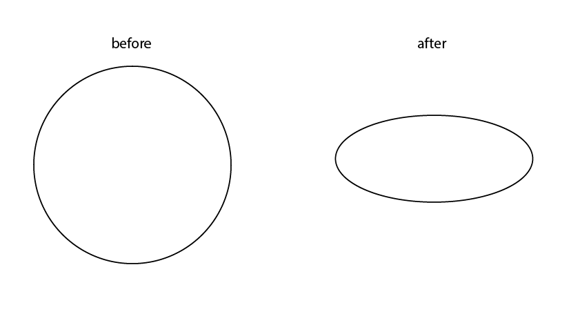

Noob here. I'm trying to create a t-spline 3D sphere and then alter its shape to be more of an oval. Any suggestions?

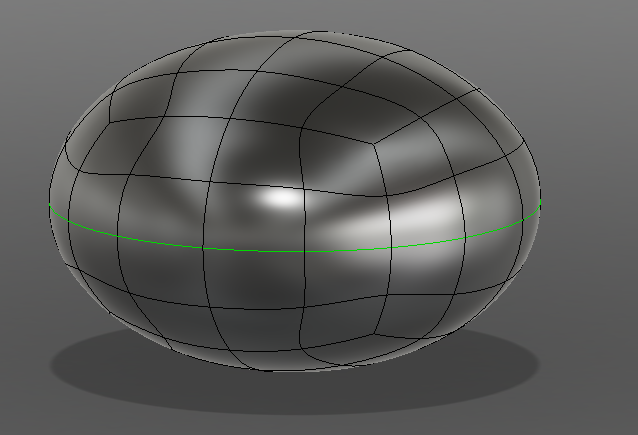

One small related opinion:  I have generally had better luck using a Quadball instead of a Sphere, unless I really want to get radial symmetry.  The vertices at the north and south poles of the sphere have a tendency to "come apart" if you are not very careful with selections in Edit Form.

TrippyLighting
I'd add that for this particualr purpose a Quad Ball has much better topology. Vertices that join more than 4 edges such as the poles of a sphere almost always generate som topology problem during editing.
