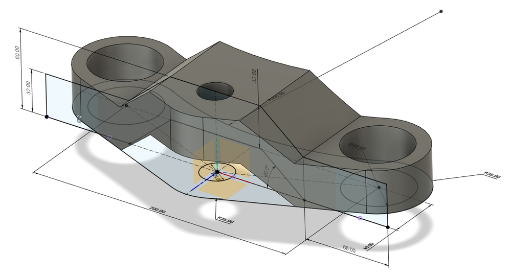

New to Fusion and I'm just teaching myself using prints I found...If someone could show me how to do these angles on this print that would be great...Thanks!Inkedmaxresdefault (3)_LI.jpg

File>Export and then Attach the *.f3d file of your attempt here.
What are these two obscured dimensions? Especially the Radius?

You should not duplicate dimensions and should not have any dimensions in your sketch that are not on the original drawing.
Simplify your sketches.
Add Fillets last (or as late as possible).

Depending on the assumptions made (there is not quite enough info on the drawings for everything) the 22-deg slot angle is NOT quite parallel to the outside face, and thus the tightening screw cannot be exactly perpendicular to both the slot and the outside face.
It IS pretty dang close, and so will probably work as intended regardless, but I wonder if it represents a rounding error in either the 22-deg angle displayed, or the 100mm and 40mm X and Y distances between hole centers.
Anyway, I chose to make the hole perpendicular to the outside face instead of the slot. Here is my version:
https://knowledge.autodesk.com/community/screencast/ff598f2d-5bfb-430d-bf3b-a8c92f796506

I notice your 66mm distance the the upper inside 30mm radius is to the center of the radius on the surface.
While mine is to the center of the radius 2mm below the surface (under the eventual fillet), which I though was what was shown on the drawings.
That makes the top-side angled faces of my part further out than yours.
Also my slot at the 207mm radius assumed the opposite side was a concentric arc, while yours has the opposite side flat.
Also my tightening holes are very closer together than your are, owing to the previously mentioned 22-deg discrepancy and that we each chose a different spot to measure from, and, oddly, different lengths.
So...three differences in our final parts. Otherwise they overlap exactly.

1. I didn't spend a lot of time on this, but I thought I had it right.
2. After looking again, I agree that this should be arc on both sides.  When I look at the drawing it looked straight to me, but from a manufacturing standpoint it should definitely be curved.
The more I look at the original drawing the less I like it.  That counterbored hole for the tightening cap screw should be clearance size on the counterbored side of the slot and tap drilled size on the other side of the 22° slot.  Let's see if the OP returns with questions.
