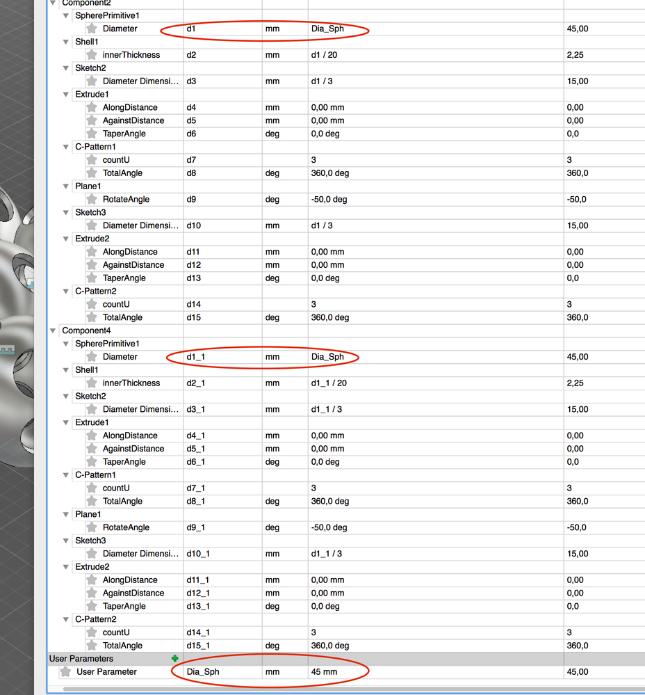

Took another approach to the spheres, this time with components and rigid joints.
The sphere diameter drives the hole diameter and the sphere wall thickness, you can change this in the Parameter window "User Parameters".
Here is a screencast: http://autode.sk/1AEE57m

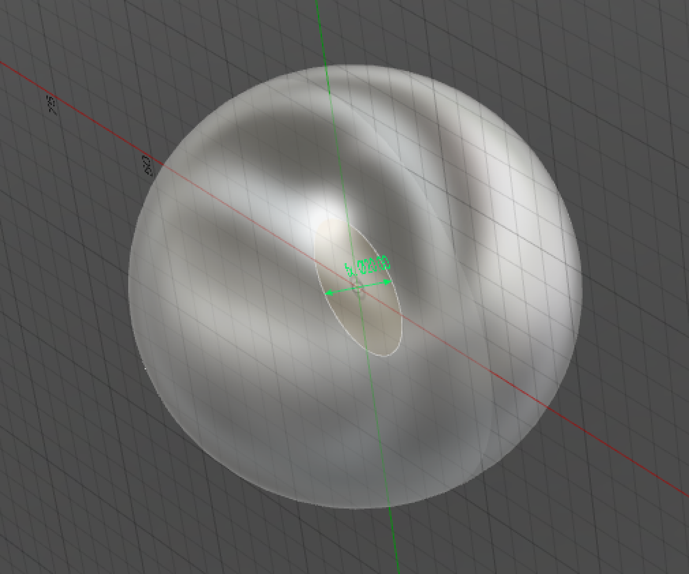

Step 5) Shell the Sphere with a wall thickness of d1/20 you can change this to suit your design,
Step 6) Create Sketch on the red/green axis plane,
Step 7) Circle on the Origin Point Diameter d1/3, then stop sketch.
Step 8) Extrude Cut the Sphere with the circle, use the settings as shown,
Step 9) Circular Pattern this extruded feature,

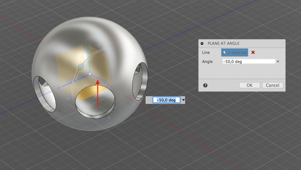

Choose the Timeline feature (extrude cut) as Object, the green axis, the features icon as Pattern Type, 3 occurrences.
Step 10) Plane at Angle,
Choose an angle that suits your design,
Step 11) Create a Sketch and a Circle (d1/3) at the Origin Point, stop Sketch.
Step 12) Extrude Cut this circle with the same settings as step 8, Circular Pattern this feature with the same settings as step 9.

Step 7) Create User Parameter for the Sphere's diameter (d1 and d1_1).
Step 8) Change User Parameter Dia_Sph (you can use any other name), and see how the model reflects these changes.
This concludes part 2 of 2.
