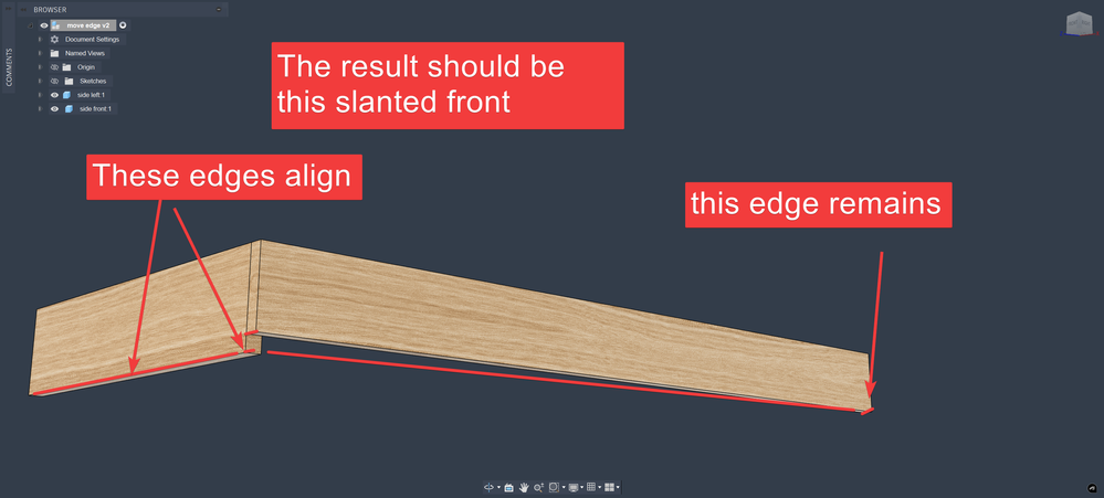

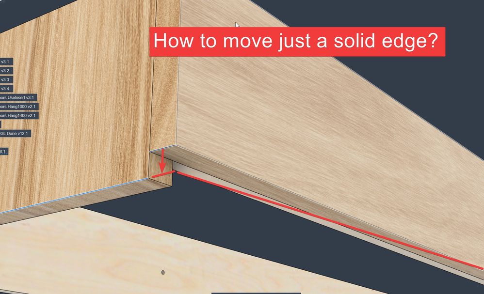

How to move just a solid edge?  My intuition is to select that edge and simply try to move it.
See screen shots, video demo and f3d file. https://a360.co/41pbumB

Hi @tookemtoni
One suggestion is to use a sketch with the required profile and use the extrude option.
Please check on short screen recording click here

Hi @tookemtoni
You can use Direct Edit here if you know the angle which you need to move the edge by. The more accurate solution would be to do what @praise.tomWX9P2 suggested and use a sketch and extrude. I have attached a video for the direct edit if you wanted to try.
(view in My Videos)

TrippyLighting
If you do "that", how are you going to address the emerging triangular sliver at the bottom?
Message 5 of 8
tookemtoni
good point @TrippyLighting But it wont matter for the base on this cabinet. See screenshotFusion360_yhkiV74Oin.png

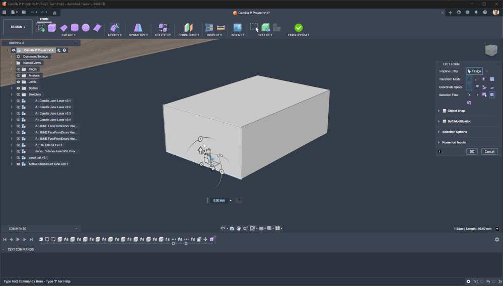

I would love to see solid modifications via edges (and points) as fast and easy as we can do with Forms (T-splines) in Fusion.  See GIF.
