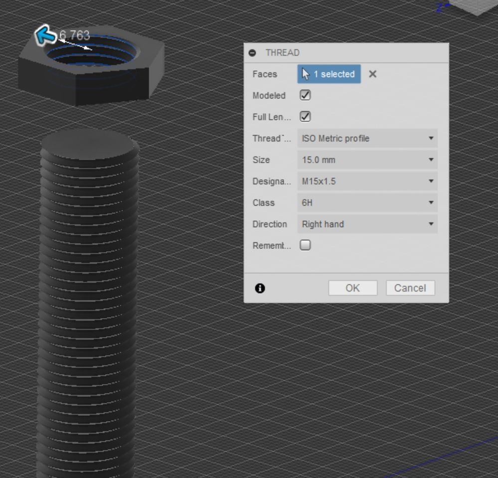

I was wondering if it was possible to motion link a threaded nut and bolt. I know that there's a "cheap" way to do so on this post:
http://forums.autodesk.com/t5/design-validate-document/simple-nut-and-bolt-joints/td-p/5375873
...but I was wondering if there was a more "elegant" way of doing so. One where the threaded parts are in actual contact with each other, rotate in harmony, and not clash or clip each other. Similar to this video:

Message 7 of 20
TrippyLighting
Yes, you need to set the correct pitch/motion ratio in the motion link. Also looking at the screenshots I see the you are using contact sets.
Use proper joint limits and delete contact sets. They are an absolute performance killer.

Thanks for the file and video. Certainly helps a lot. However, the problem still remains: the nut's threads and the bolt's thread still overlap when in motion. Even with the z-axis offset AND the motion link, the treads still overlap as you can see above.
Message 13 of 20
Beyondforce
@MichaelTewasart, that is quite simple... your Pitch is 1.75 = 360 dg turn, the Nut travels 1.75mm 😉
This is the Pitch of the Thread you are using.

I set the motion link's distance the same as the pitch thread and it works perfectly! The threads for both the nut & bolt don't clip each other. Thanks so much! I have a few more questions:
