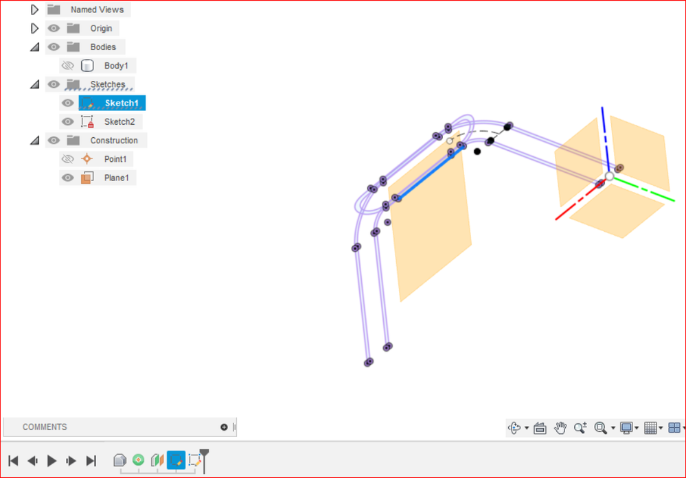

Hello, I'm working with a .step file which i've opened in F360 that has body, but not the sketch. When selecting inspect then selecting the pipe bend face, no radius/ length/ diameter is displayed like it would for a sketch line.
Any chance someone could advise what one needs to do for the following:
1.) Determine (measure) the centerline radius and angle of the bends
2.) How to modify the bend radius and lengths of the straight sections
Is there a way to create a sketch that would follow the centerline path of the pipe in the .step file which could then be used for modifications?

1. The arc radius of the centre line is 1 inch, both bends are 90 degrees.
2. Depends on what you want to modify.
Make your own model, armed with the info from 1. above, hard to know the how, without knowing the answer to 2., above.
You can take a Project > Intersect on XY plane sketch, and an Offset plane at 5 inches, will copy this pipe.
Centre leg is 3 inches. (blue line)
Might help....

I would make a 3D sketch
Then create a pipe so you can change whatever you want.

Click >>Reverse Engineer Pipe<< here.

This is excellent! Very helpful, thank you.
